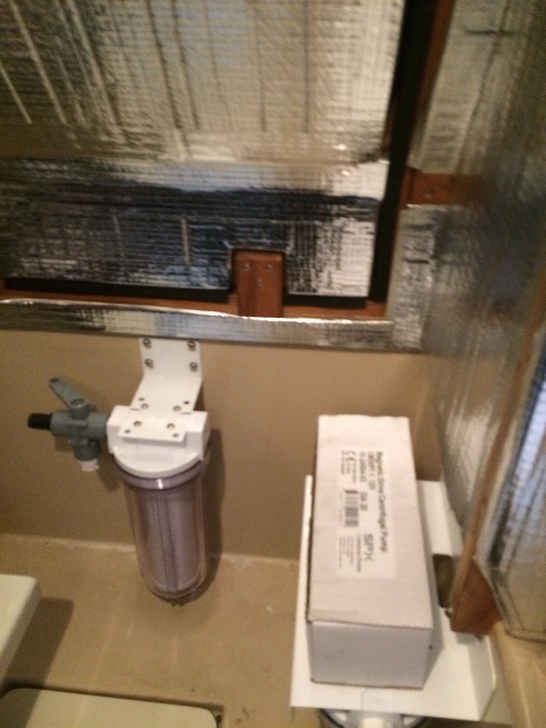

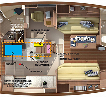

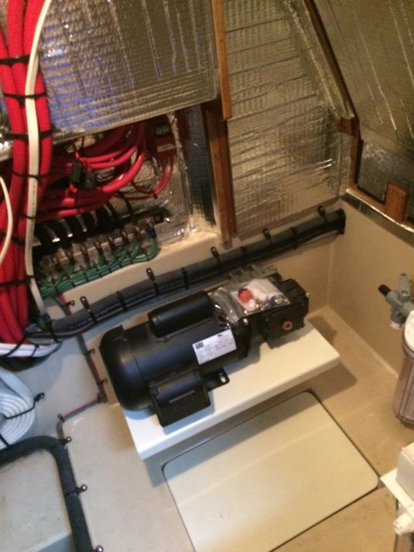

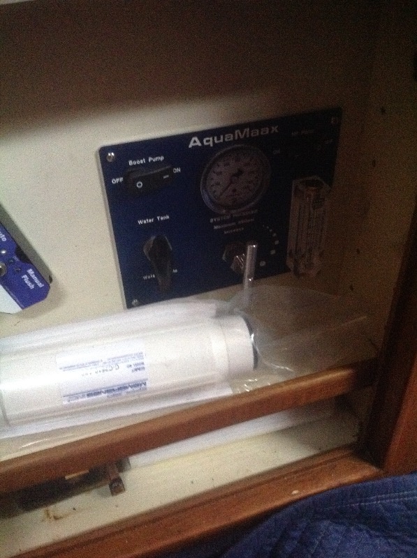

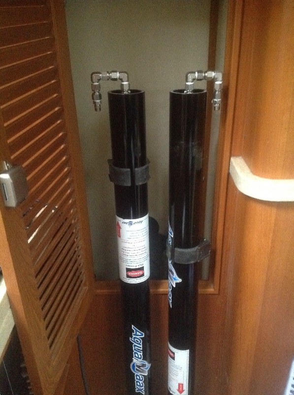

The installation of a new Aquamaax water maker is underway for our IP465.

Your photos and your plan and installation is looking good. Since you have a genset, it make sense to install a 110v system which will make a lot more water than a 12v system. We have no genset, so we are installing a Spectra Ventura 200t which will make 8 gal/hr and it will dray 10 amp so we are hoping to run this off wind and solar at mid day or when motoring. Thanks for sharing your plans and progress.
