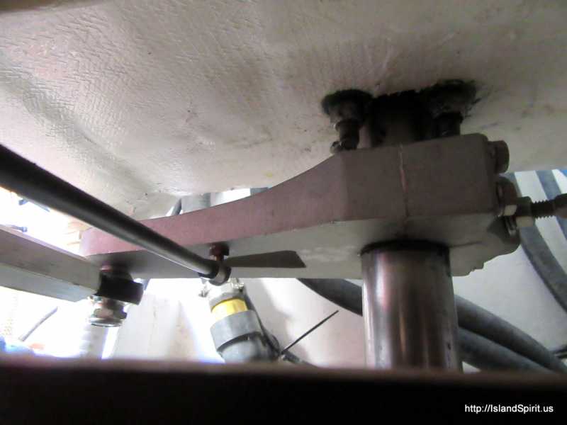

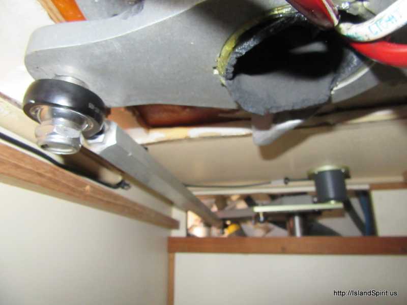

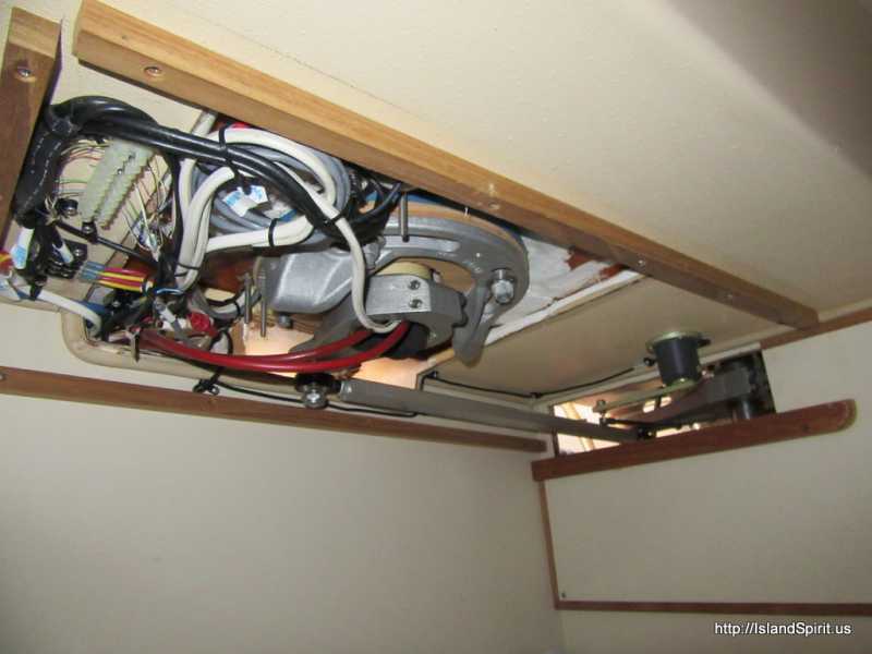

Here are some photos since I had to take apart the cover to get these measurements.

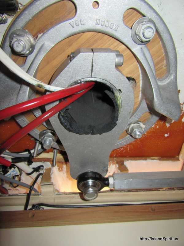

We did purchase the helm and the specifications all look good for a fit. One question I have. Did you cut a key-way in the rudder post and if you did, how did you do it in the boat?
10 years 5 months ago #4671 by hayden
Replied by hayden on topic Pedestal Change IP35
We did not cut a keyway into the rudder post. We drilled a hole as the Edson arm included a treaded bolt with a point to go into the rudder post.

The machine shop who is boring the tiller arm thinks a bolt is a bad idea as too much torque on it and suggests cutting a keyway in the arm and shaft. Don't really want to drop the rudder, so he also suggested having the key tig welded on the shaft. Obviously Edson felt the bolt was fine for our boat since they will build them either way. Think we may just go that way as I am not crazy about dropping the rudder or welding in the boat.

In picture 5 above, you can see the Edson arm clamped onto the rudder post and the bolt on the arm. We drilled into the rudder post and this bolt presses into that hole.
The arm is very tight due to the clamping of the arm around the rudder post.
This has 20,000+ nm on it.
We did not drop the rudder.
