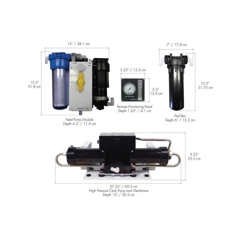

Where are you planning to locate the Ventura 200T on Island Spirit. Once you have her installed, I would love to see your pictures of the installation and location.
9 years 11 months ago - 9 years 11 months ago #5198 by hayden
Replied by hayden on topic Mack Sails is more than sails
Jimmy:
I plan to install the Spectra Ventura 200t as follows:
1. New 3/4 thru hull and seacock in galley floor, completed
2. Feed Pump Module and filter inside sail locker, forward edge bolted to cockpit seat ice box. There is a 7" x 15" space up under the fwd edge of the sail locker lid. This is unused space and will allow the pump to be out of the way.
3. The Clark Pump and Pressure tube assembly will go onto a newly glassed in shelf that will be against the hull up as high as possible to the deck directly outboard of the forward edge of the sail locker lid. This needs to be reachable to turn the pressure relief knob. I may need an extended tool/dowel rod w/rubber foot.
4. One extra filter may be installed before the feed pump.
5. Sea strainer will be installed in galley floor as well.
6. Brine discharge will be connected into the cockpit ice box locker (small seat locker to starboard) that already has a drain hose to the boot stripe and a seacock.
7. Supply product water will be connected into the deck fill hose with simple PVC connections and water hose connections.
This install should not take away any storage space currently in use. All the areas I am using are spaces that are not used in any way.
That is it. The Spectra Ventura 200t is manual, but can have an automated system added for $1500, nope, not doing that.
The Spectra dimensions are here:
More details here:
www.spectrawatermakers.com/us/us/11124-ventura-200t
