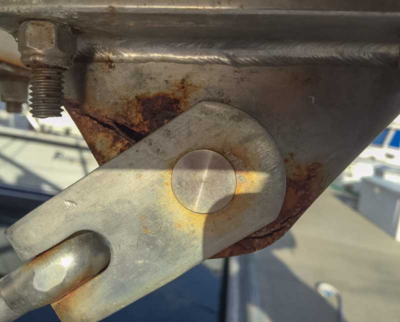

Nevertheless, the guys came out and made short and efficient repair of our line. To their credit, as they departed the boat they noticed some corrosion on the Bobstay chain plate.
That led to a complete rigging inspection, the replacement of two stays and the chain plate.

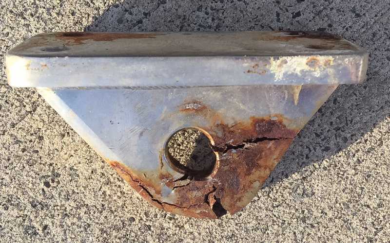

That crack has been forming long before 2013 and should have been caught in the survey. Regarding your gear box failure. Many people do not realize that catastrophic engine/transmission failures may be covered under their insurance unless expressly excluded on the policy or can be deemed a failure due to maintenance.

Good point. The Bobstay attachment at the waterline was replaced after survey in 2013 and that Chainplate was in good condition on visual inspection. We had it reinspected once again in 2014 along with the entire Bobstay rigging. This failure came on in the interval.

That is incredible for it to go that far in such a short time. Glad you got it when you did.

Fantastic documentation and photo details. This bobstay structure is one that needs inspected yearly. I want to take mine apart at the bow sprit snd replace the 4 bolts that hold this assemble together. I have heard of one ip40 that had these bolts fail. These bolts can't be inspected unless removed. How did the 4 bolts look on your assembly?

We think so too. We don't have pictures of the area anymore from 2013. The riggers think the problem came from a mismatch of the Bobstay retaining pin to the chainplate. Credit goes to Key Riggers. They had sharp eyes. We are very grateful.
As for the hold down bolts. Two of the four fractured on removal. For sure Hayden. This area should be looked at annually and those hold down bolts should be replaced on a schedule.

In rebuilding my antique wind vane I learned a lot about stainless steel. 304 is most commonly used, especially for bolts, but it is prone to crevice crack corrosion. 316 is slightly weaker but doesn't seem to have the corrosion problem. I've found that stainless from China is junk and will corrode in quick time. I wonder if that chain plate wasn't made with 304 or worse yet, Chinese 304! I would think the combination of stress and salt water corrosion would point to 316 for this location.
