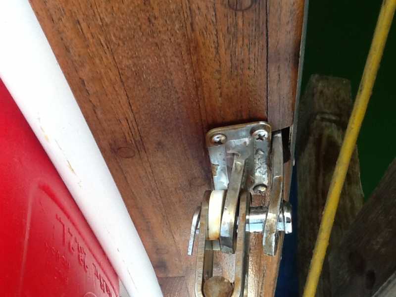

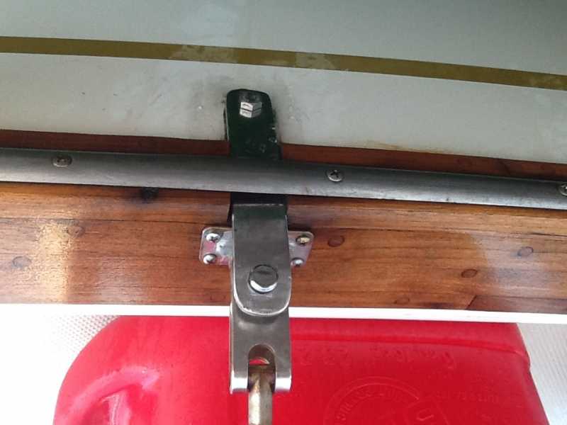

We have just completed the external chain plate replacement modification to our 1985 IP-31. Our research data showed that in over 200+ IP's the factory only knows of 7 failures. Most of these were due to dissimilar metals of the welding rod and chain plates themselves primarily in older IP's. We had only evidence of one of our 6 shrouds showing signs of weld failure. We went with "stubby" externals which only extend less than 5" below the caprail. They are thrubolted to existing encased horizontal chain plate structure which showed no signs of stress or corrosion. Cabinets did have to be removed and replaced but this is pretty routine for the knowledgeable IP carpenter/technician. We are very pleased. Cost $1900 labor and materials. Sorry, I'm 900 miles from "Nomad" so pictures will have to come later. Mike and Carol, "Nomad" IP-31 #49

We had the Island Packet factory guy, Randy Myrick, who moonlights in the Sarasota/St Petersburg area do the work. He is the same one who also installed our new solid tongue&groove teak cabin sole. He's been at the IP factory for over 25 years . Great craftsman and wonderful guy. PM me for contact info if you wish. We have no data about the integrity of external chain plate modifications but the collective experience of the factory techs is that it is very rare that anything BUT the welds on the tabs is the failure mode. These external stubby plates tie directly into the horizontal "H" of the fiberglass encased chai plate anchoring system. We're confident. Pictures later. Mike "Nomad"

Enclosed are a couple of pictures of our 'stubby' chain plate attachments. Note that the tabs of the original chain plate are still intact. So, essentially these are additional fortification held by larger, longer clevis pins and relieve any stress that may be on the suspect welds. These are drilled directly into the upper horizontal bar of the original anchoring system as these have no signs of rust or deformity in the hull attachment straps. Hope this helps. Mike Raceboat61-S "Nomad". IP-31 #49
