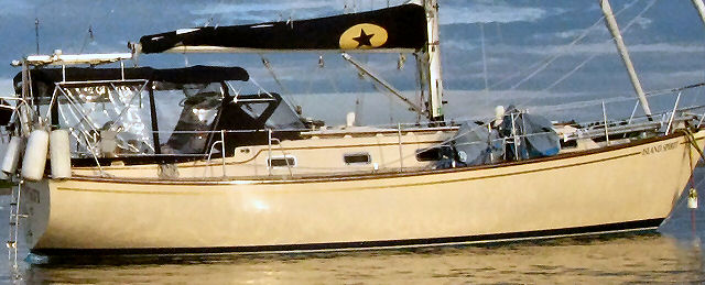

Another IP owner, Ed L. IP37 suggested that we use Krylon Fusion spray paint to paint our plastic sump fittings for the shower and the bilge on the stern. We did, and that worked out really well. It worked so well, we decided to also try his other suggestion for our boot stripe! WHAT? That's right, we re-painted our entire boot stripe with a $5.00 can of Krylon Spray paint from the local Ace hardware store. The bid to re-paint the stripe by the boat yard was $1,000 so we said no thanks. Now after nearly 4 months of hard use, and cruising from Maryland to Maine, I can report that this stuff really holds up. It has not flaked off or faded. All I was planning on doing was just to touch up the scratches. Once I started, it looked so good, we painted the entire IP35 boot stripe with 2-3 coats with one can. We did tape off the stripe, and the spray was very easy to control. UNREAL how fast and easy this was.
So, if your boot stripe is looking bad, then give this a try.

17 years 1 month ago - 14 years 6 days ago #168 by hayden
Replied by hayden on topic Re:Krylon Fusion for Boot Stripe
So far this seems to be working just fine. Here is a photo of the boat in Acadia Maine after the trip from Rock Hall, MD to Maine. No flaking off, no chips, looks great. I will try to get some photos of a close up as well.

14 years 6 days ago #1590 by hayden
OK, it has now been a few years and this $4.00 spray can of paint is still holding up well. Here is a photo of the boot stripe in Newport News, VA after a year run from Maryland to Key West to Abacos to Maryland. It still looks great. If I were to do this again....I would do exactly the same thing knowing what I know now.
Bottom line....BOOT STRIPE PAINT with a $4.00 spray can of Krylon works just fine!
