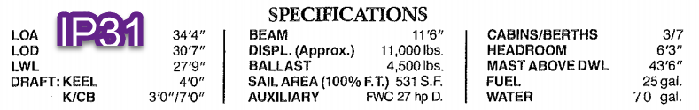

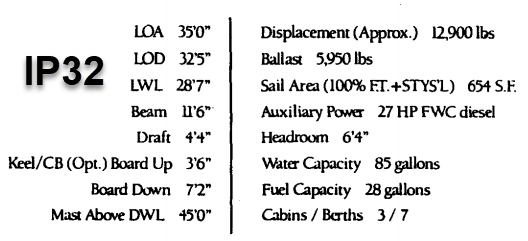

Start off with the two specs IP31 vs IP32:
Island Packet 31
Island Packet 32 Specs
These two yachts are very different. Look at the displacemnt and look at the ballast. Look at the LWL this will give you hull speed. Hull speed is defined and calulated as such:
  • Hull speed is expressed as 1.34 X the square root of LWL, or length of waterline. If a cruising sailboat has a waterline length of 36 feet, she should be able to sail 1.34 x 6, or approximately eight knots.
I would expect the IP 32 to be a better sailor than the IP 31.

7 years 10 months ago #6248 by Neal
Replied by Neal on topic Need help with IP 31 or IP 32
Late to the discussion, but I would echo Hayden’s comments – the IP 31 and IP 32 are very different boats. My wife and I just went through the same experience as you. Coming from catboat sailing we were drawn to the shallow draft of the IP31, especially the centerboard model (only 3 feet). We looked at a number of them but for whatever reason didn’t feel ready to make an offer. Then we saw a posting for an IP32 nearby and were sold. A few additional thoughts:
Significantly, the boat was bigger in every way, feeling more like the IP35 (which we also looked at) than the IP31. If you’ve been aboard both you undoubtedly noticed that below decks the forward cabin and V-berth are much roomier, the quarter berth bigger, and more stowage overall, in part because the hull form (I assume) allows the settee lockers to have more volume and both the water and fuel tanks to be located under the cabin sole.
Another important difference for me was engine access. Whereas there is a large hatch in the cockpit of the IP31, it appeared that all the routine maintenance, which I do myself, would involve hanging over the engine from above. In the IP32, the engine is accessible from the cabin and the quarter berth, which I find better.
Also as Hayden noted, the hull design was reportedly improved and we’ve been perfectly satisfied with the performance. The draft is a bit more than the standard IP31 (4’4” versus 4’0”), which we felt was still shallow enough for our coastal sailing and motoring|sailing the Great Loop if we wanted. I don’t recall any substantive differences in deck layout, except that the IP32 cabin top is taller and a big step up, though not too much so for us.
We still like the IP31 very much, and I’m sure we would have been very happy with any one of several in great condition that we considered. Quite pleased with our decision, however.
