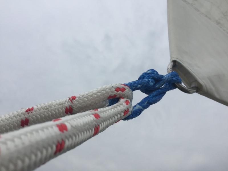

There's a lot on this on the various IP sites. On my IP27, in wind above 8 knots or so, I make sure to back the genoa until the boom crosses over, then blow the old sheet and haul in the new as quickly as possible. The sail then blows through the slot. In light wind this works about half the time, and the other half I have to go forward and walk the sail through -- but in light wind this isn't a problem. I've also found that using a soft shackle to attach the jib sheets to the clew decreases the chance of a hang-up when tacking (see attached photo); bowlines -- especially two of them -- frequently get hung up on the inner forestay. ML

Many thanks to responders. My fear was that I was incompetent but sharing reveals there is an issue and that special care in in order. I like the idea of a ‘soft shackle’ and will try it. In the meantime I’m working on it ....
