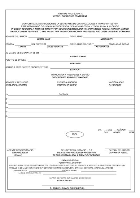

Before departing your last port for Mexico you must secure proof of the port of your departure. This Carta Mandato (mandatory letter), is a necessary document to present to immigration upon your arrival. Note that it is not necessary to have this prepared by a US immigration official. Simply present yourself before a notary public, properly completed, sign it, get your signature notarized and you are done. Andromeda's first Importada issued June 6, 2007. Upon her return to Mexico, 10 years having passed, she needed a new Importada. I did the paperwork cha cha at the Officina del Capitania del Puerto de Cancun, paid their $60 US fee and Andromeda now wears her new Importada decal on her aft portside port window. (How about this for an unexpected requirement: Pesos are not accepted as payment of this fee by the Mexican government! I had nothing but pesos, except for the fortuity that I was armed with a Visa credit card which was accepted.)
