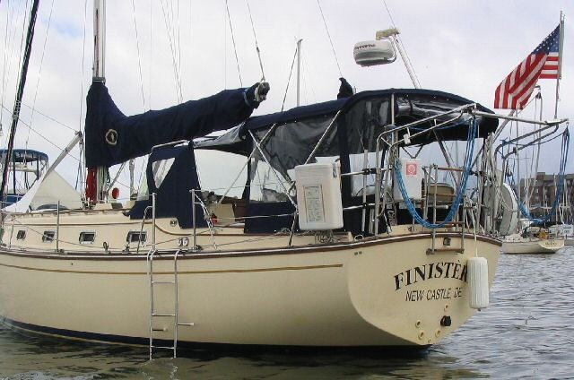

Makes sense about the swim platform. I think we will board mid ship. Does anyone know where you could but a conventional stern ladder for getting on the boat from the water while swimming in calm conditions?

I found a ladder from another IP owner and it woks great. Thank you to everyone for your help.
11 years 5 months ago - 11 years 4 months ago #3904 by hayden
Replied by hayden on topic Re: Swim/Boarding Platform for IP40
Is this the ladder you were directed to by the other owner? This is the best one I know of on an IP 37 from Rock Hall, MD..
Here are more photos shared by Ed.
ipphotos.com/view_ad.asp?Ad_ID=328
The ladder presented in this photo is by MYSTIC STAINLESS and the link is here:
www.mysticstainless.com/foldaway.html
