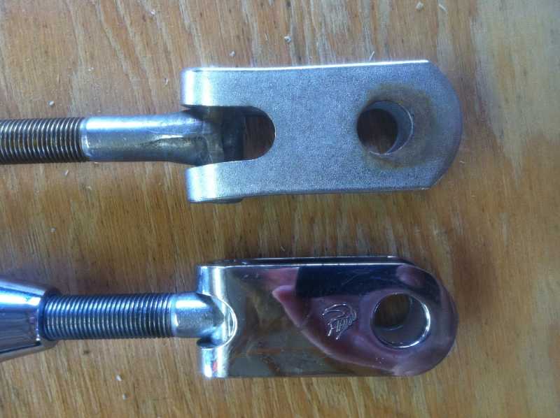

14 years 5 months ago #1174 by eau-de-vie
Here is a photo of the turnbuckles from the boat vs. a new one. Note the elongation over time! This emphasises why the work needs to be done and checked periodically.
