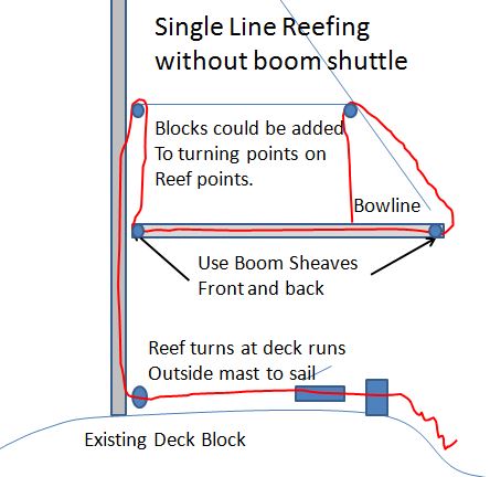

I have been looking at the idea of removing the shuttle blocks in the boom and simply running single line reefs. The goal is to eliminate the boom shuttle so that the reefing lines run easier and free. This idea can be accomplished with out adding anything and by just using existing gear. To improved on the idea, blocks could be added at the sail friction points, but may not be needed. These lines would need to be monitored for chafe but then again, it would be very easy to simply cut off the end and tie the bowline at a new point.
My idea rigs like this: Start at the cockpit, run to the mast using existing reef gear, turn at the base of the mast go up to the reef point in the sail, turn back down run into the boom at the gooseneck. Run out the boom end and up to the sail reef point, turn and come back down to the boom where you tie a bowline around the boom.
This is illustrated here.
I have not yet installed this, but now with my boom and mast off, this may be the time to try it out.
What do you think?
It seems to me that this would work well, and there really is not much force when reefing if you drop the halyard and keep the tension off that. Then once it is in, you can load it up with the halyard again.

This is exactly what I have been considering (per your diagram). Since my boat is in Jolly Harbour, Antigua I am faced with a couple of issues-
1. Calculation of the length of each reef line. Spoke with factory and they gave me a couple of formulaes. Ex. 1st reef aft 1.5 x E and 1st reef forward 4.0 x E. Got a total of 77 feet. Does this seem reasonable?
2. Thoughts on line diameter. Thinking of using Sta-Set. Have used Sta-Set X on other boats, but seemed stiff to handle. Priced Dyneema, whoa!
Thanks, Mike

I thought I had the dimensions on a drawing but I can not find it. I actually measure my sail reef points for this exact idea. I ordered the reef lines and I have them on the boat. I will not get to the stored line for a few weeks so I do not have the measurements. I can measure this again about the 3rd week of Nov. As for line, I bought the same size as the IP factory reef lines were original.

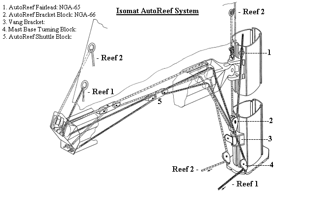

We have a PROBLEM.....my above sketch will not work with the factory original Isomat Auto Reffing system due to the fact that then boom sheaves drop into the boom ends from the top. So, in my sketch, you will see that the reef line forces will pull the boom end sheaves UP and out of the boom. The Isomat design pulls DOWN on the boom end sheaves and they stay in place.
So, it looks like the solution would be to drill a through bolt in the boom caps making the sheaves ride on a fixed shaft that can not lift out of the boom.
Since I do nto want to do this, I will be rebuilding my boom with factory original Isomat setup. Not sure this is the best solution, but that is what I am looking at now.
Here is the Factory Isomat Orig: Notice the direction of loads....down
www.rigrite.com/Spars/Isomat_Spars/Isoma...Isomat_AutoReef.html

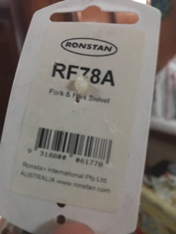

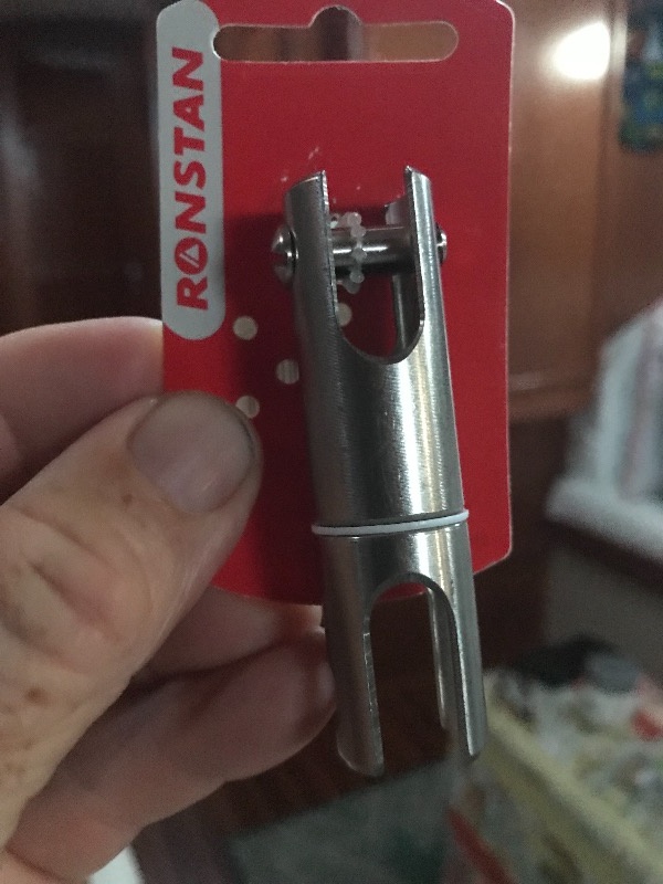

7 years 7 months ago #6102 by pktLvr
Replied by pktLvr on topic Re: Single line mainsail reefing on IP35
The photos are of a Ronstan fork and fork ball bearing swivel, part RF78A. It should work as the boom car body.
Using this will only eliminate half the twist. We have a twisting and twisted end of the line. The twisted end should be relived, but the twisting end will be unchanged.
I plan to mess with my reef lines in the next weeks to see if there is a ‘best practice’ that will prevent the twist.
