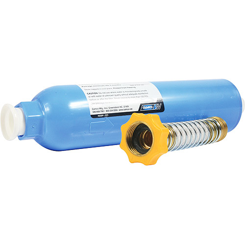

I too use to have this problem on IpP35-165 1994 model and as Bobby states, it is from the chlorine in city water. Once you start using a Camco Water Filter on your fill hose BEFORE filling the tank, it will eventually go away. I have not had a problem since using this, and eventually all the crystals will filter out.
$17.00 per filter, I use one per year from Walmart, see the camping section.
www.walmart.com/ip/Camco-Water-Filter-with-Hose/14504321
See picture of what you need:

Something wrong with the specs on this filter - indicates 100 micron filter capability. Most sediment/chlorine filters are spec'd in the range of 2 - 5 microns and are only good for a few thousand gallons.
Is this the right filter?
Bobby

The company says this removes chlorine and that is what I use it for. It has done this and has stopped the alum chloride crystals that use to build up in the tank. Call the company here for more specs:
www.camco.net/

Understand but given the lack of info on line on this filter and without knowing how much chlorine it removes I would be suspicious.
Just sent you a personal email on this filter. This is similar to what we use and uses the replaceable element.
www.pplmotorhomes.com/parts/rv-pumps-water/rv-water-filter.htm
