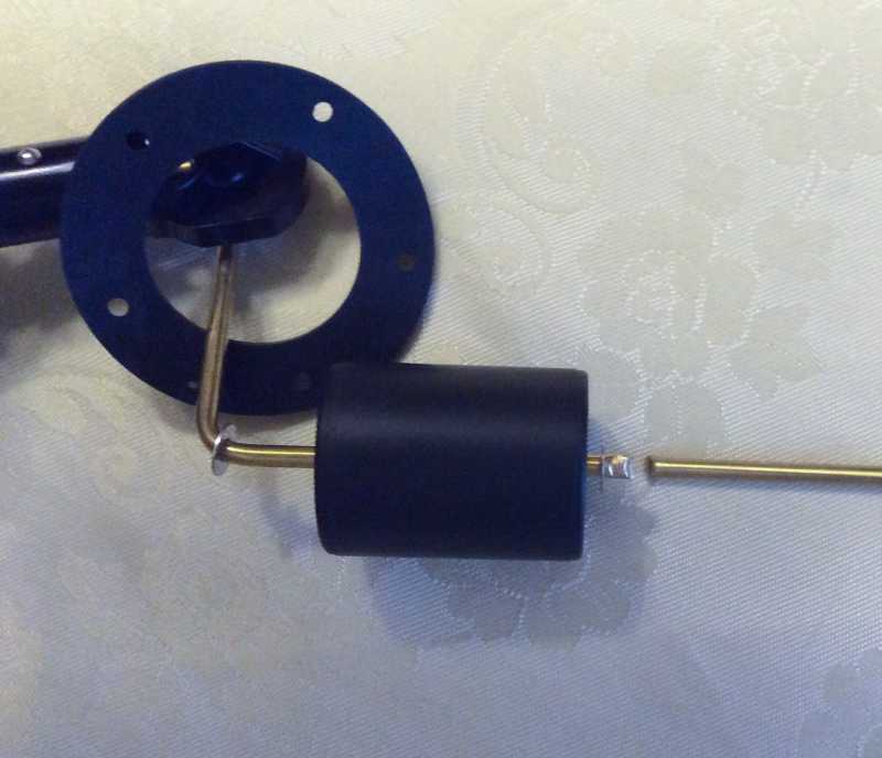

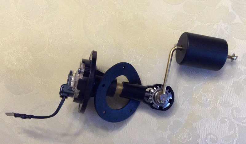

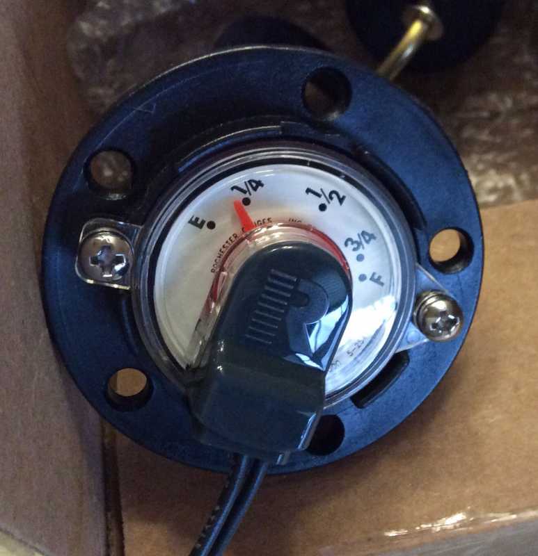

:cheer: thanks for the question. See the photos I have included. The sender is a standard 5-hole with gasket. 240-30 ohms dial.

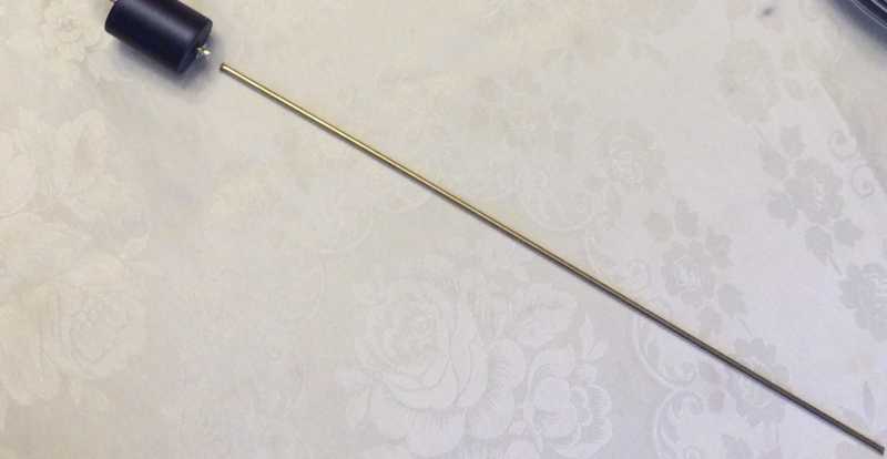

The generic portion of the sender is the float rod. It comes as about 18 inches and can be shortened to properly fit the tank. You will need a bolt cutter, and long-handled crimpers to shorten then re-crimp the rod end and hold the float on the rod. The sender comes with diagrams and a conversion table to size the fit to various size tanks. The dial needs to be mounted which is fairly straight forward.
I did practice crimping and cutting several times before going down to the final 6-inch length to fit our tank.

Thanks for the pictures but I am a little confused with the third shot. You made the float arm much shorter than what is currently in my tank. How does it reach down to the lower portions of the Tank?

I have attached the drawings for the Rochester Guage Sender. As you can see, you customize the final rod length to match your tank depth. Our tank sticks at 6-inches deep. So the final cut of the rod was set to get the full length.
The float rod pivots from the empty position (straight down) and rotates 90-degrees to the full position as the fluid level in the tank changes.
