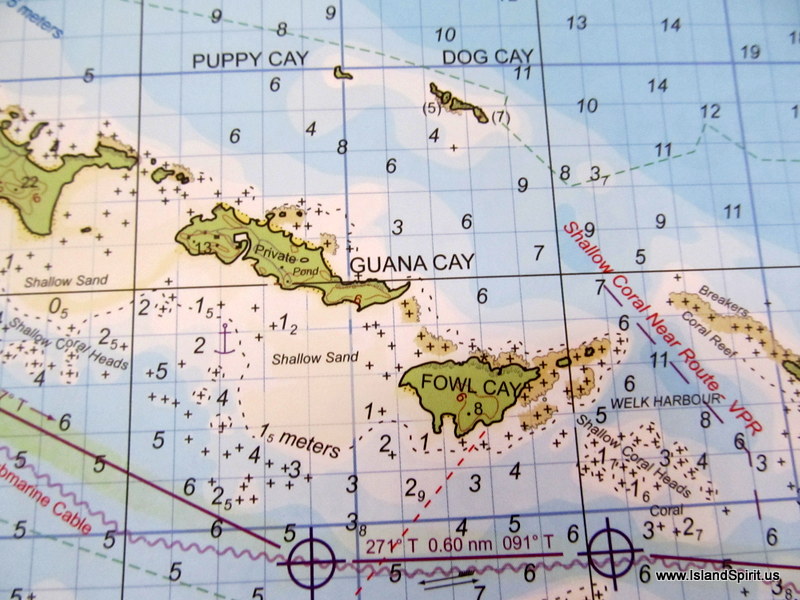

This is the PAPER EXPLORER CHARTS, look at the REEF next to FOWL Cey

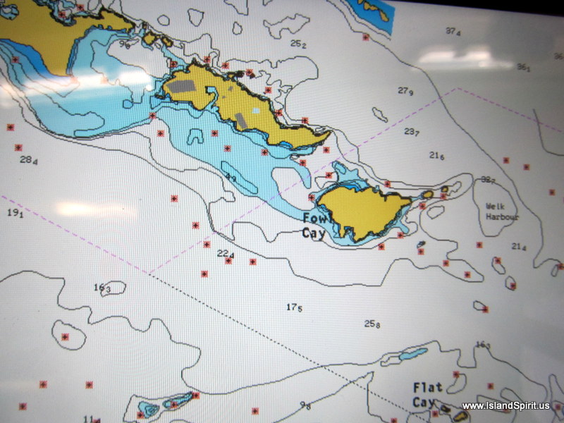

This is the NAVIONICS APP....LOOK....a course line next to FOWL CAY!
This is where the Cat sank due to this app !!!

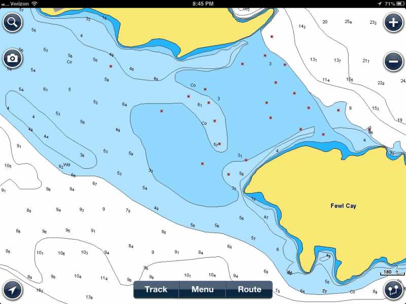

Hayden,
Thanks for the update on chart quality in the Bahamas. Attached is a pic of Fowl Key using my version of the Navionics App. It shows numerous symbols for rocks in that same area and no route through there. One of the symbols mentions that explorer.com maps are superior. I wonder if perhaps you have an older version of Navionics? I don't know how to imbed the screenshot into this note, so will add it as a photo and provide the link.

13 years 7 months ago #1911 by hayden
Replied by hayden on topic Re: Navionics NOT for Bahamas
Randy:
WARNING.....WARNING.....WARNING.....
What you have shown is the COMMUNITY LAYER in your app. Go to your settings and TURN THAT OFF.
Community Layer in Navionics is where you and I and any willy nilly sailor can add marks, buoys, waypoints and anything they want!!!! WHat?.....yup.....anyone can add a buoy anywhere and then you think this is GOOD TO FOLLOW.
That is a very dumb idea!!!!!
Here on your example, a user has added these marks AFTER THE CAT HIT THE REEF. Yes, this will prevent another boater from hitting this reef, BUT....this is NOT NAVIONICS data, it is data added by the users of the program.
So, If i were a bad person, I could now add buoys in bad places and people using the program would follow my points and run aground. This could be a fun and sick game.
If you use NAVIONICS:
#1: TURN OFF THE COMMUNITY LAYER, do not rely on the willy nilly sailor to add data
#2: DO NOT USE THIS IN THE BAHAMAS except for reference and study!
Thanks for adding the picture.

13 years 7 months ago #1915 by rhpike
Replied by rhpike on topic Re: Navionics NOT for Bahamas
I agree with Carey. I turned off the user edits and it still shows coral and rocks in that entire area. Plus, I always have anything less than 6' of water depth shaded blue. See attached screenshot. I certainly wouldn't have sailed through that cut! However, I still do appreciate the info re Explorer charts for the Bahamas.

13 years 7 months ago #1917 by hayden
Randy:
Thank for that photo, that is closer to the Explorer charts.

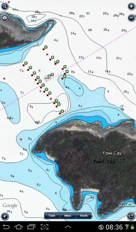

13 years 7 months ago #1918 by Carey
Replied by Carey on topic Re: Navionics NOT for Bahamas
This attach should show what my Navionics chartware (Android tab) shows.
Definitely not passable !!!

That screen capture is showing the COMMUNITY LAYER with marks that were put into Navionics AFTER the cat hit the reef. Turn off the community layer and THEN look at this area east of FOWL CAY.
I am not trusting any COMMUNITY LAYER pins, buoys or marks. I want the chart markings and that is all.
The fact that Navionics is allowing users to add buoys and marks into their software is really messed up. It is not like Active Captain where the user data is supporting data to help. These community layer looks like OFFICIAL BUOY MARKS, and people are now trusting them. If you look at Navionics for ST. AUGUSTINE, you will see the same issue of community layer buoys added my users.
