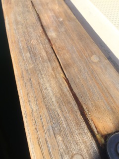

Next question :unsure: Now that I have successfully gotten the hang of stripping, I have found on the starboard gate for entry into the boat, the teak is not a single board but a stack of 3 boards. The top board has some gaps both across the horizontal side and more worrisome on the vertical side where the stainless rub rail is attached. It looks as though there was some loose filler/sealer that I may have scrapped up during the stripping process.
:sick: Any advice on what do with this. It looks like a place where moisture would love to insidious things to the teak.

I used a good quality wood filler but you could use resin also. When you varnish over those blemishes, they are sealed. When you put the stainless back on, be sure and use SilPruf in your screw holes before you put the screws in. There is a trick to putting that stainless back on.
Do NOT start at one end and start putting the screws back in. Put a screw in at one end and then the other end. Then put one in the middle. After that, put one in between the end and middle, then another in between those. This way the metal is placed on evenly.
