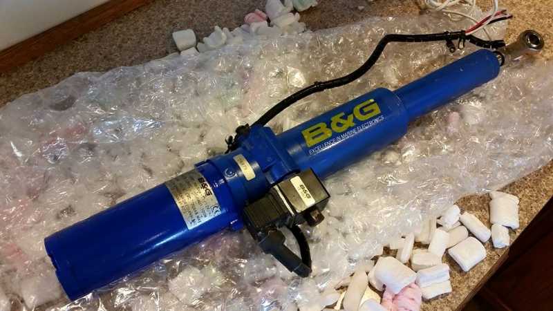

Here is my ram rebuilt and serviced!!!! Next I will send him my spar that is installed now. This unit received new seals and new brushes plus a paint job and it was tested under load. It's good as new. He says these are the best rams made.
I have to agree.

I bought the B&G brush kit. I took apart the motor and noticed it needed soldered into the board. Then I found this repair guy and he does lots of these. So I sent it all to him. He repaired it and then.bench tested it. I now have that one shrink wrapped and stored in my spare parts onboard if I need it.
The B&G rams are great.

Hayden, I had my B&G T2 RAM repaired in California about 3 years ago, it is already leaking again after maybe 6000 nm. How has your rebuild ram done so far and how much did the repair cost ? I am trying to decide if I should just buy a new one ?
9 years 1 day ago #5756 by hayden
Replied by hayden on topic B & G Repair and Service Tech
Horst:
My RAM is still running fine, and I have my second rebuilt in the bow storage. I have no problem with the rebuild by David Bourque. I would use him again. I do not recall the price.
