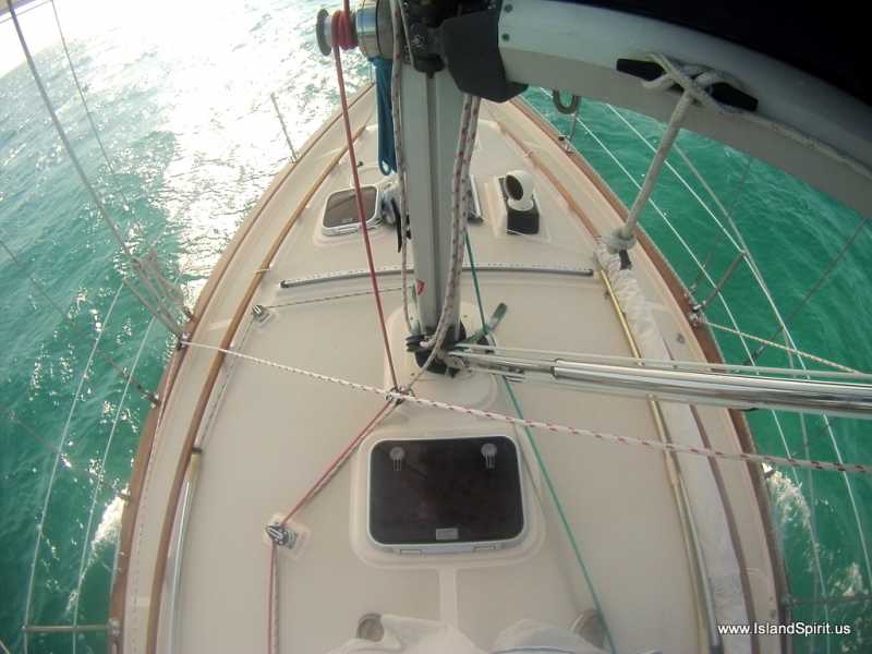

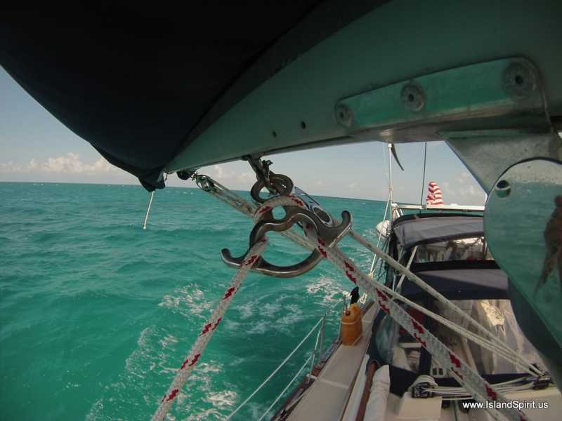

Here we are sailing downwind wing on wing from Green Turtle in the Abacos to Great Sail in 20 knot winds. I am off watch, I just came below to remind everyone how easy and how great this $39.00 super eight descender boom brake really is. This has been one of the best items I have added to our rigging. This simply works great. It locks the boom at any point of sail, and the boom will not move. It will also keep the boom fixed while motoring. If you do not have a boom brake, then this is the answer.

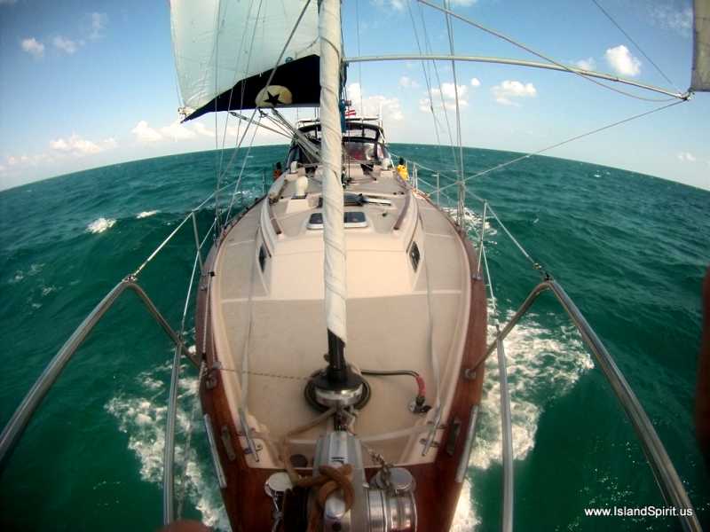

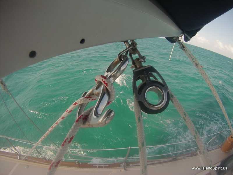

Here are a few more photos of this set up while sailing wing on wing home from the Bahamas.
