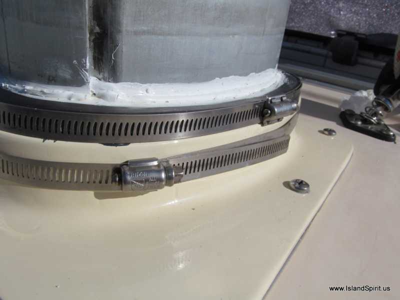

Here are some photos of the right way and the wrong way to install a mast boot and seal around the deck collar on an Island Packet 35. The mast wedge is an L shape piece of rubber where the long part of the L presses into the gap between the deck collar and the mast. The mast pin is a SS pin that goes through the deck collar and through the mast. Both of these items need to be clamped. Clamping the mast wedge presses it against the mast and helps to seal out water. Clamping the mast pin prevents it from moving side to side and coming out of the mast deck collar holes. Once the mast wedge is clamped, add silicone sealant around the joint to help with the seal. After all the the clamps are on and secured, next wrap the mast collar and joint with boot tape which works like rigging tape but is 4" wide. It will stretch twice its length and it will stick and seal back onto the previous layer. Go around and around the mast making a good seal. Finally use silicone caulk and caulk the slots and gaps due to the shape of the mast cross section. At this point your mast joint at the deck is perfect and is sealed and will not leak.
Here are some photos of this process.

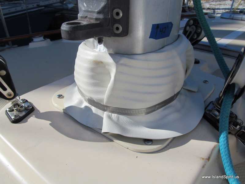

This is what it SHOULD NOT look like. This is an upside down mast boot! It leaked a lot
This is a proper job with no leaks!
This is the mast wedge with NO CLAMPS, also the mast pin is NOT clamped
Clamps added and sealant added
Notice the lower clamp around the mast pin, this is important!
The finished job, and zero leaks

I never thought of putting the hose clamp around the mast collar / wedge itself
yes the method shown looks very tight.
Is that the SS mast pin there in the middle of the 3ed photo ?? Gee, I don't think I have one of those ...
