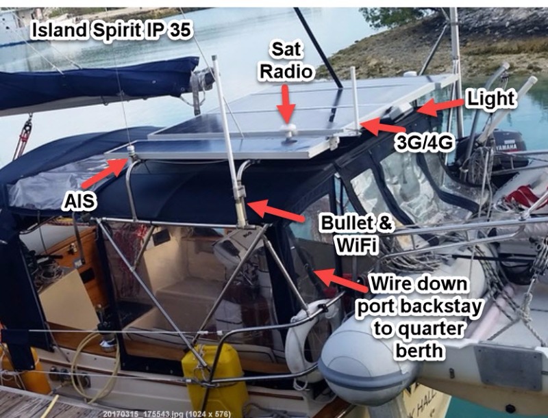

Where do you have your external,antenna mounted?
8 years 5 months ago #5879 by hayden
I mounted this antenna on the Bimini frame and it sticks up and over the solar panels. (actually, it is mounted on a bracket bolted to aft end of a solar panel which is on the bimini frame). This provided an easy wiring run down the port backstay into the back of the cockpit then into the water heater area and then forward along the port gunwale to the shelf over the hanging locker in the quarter berth. That is where i then have it plugged into the WeBoost.com 3G/4G booster. It all works well.
Here is a picture of my set up.
8 years 5 months ago #5880 by capnBH
Thanks , great setup.
