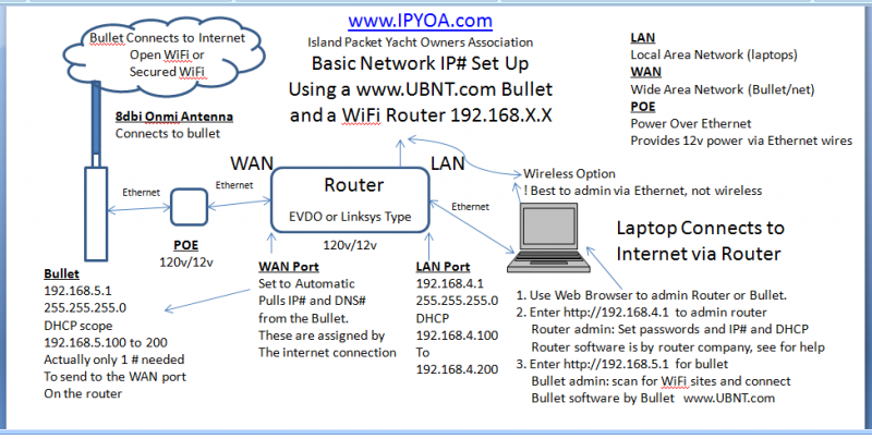

Here is a Network Diagram for this setup.

That is a full system. Now all you will need is to connect it and set it up.
Here is a network diagram of how it will be set up...
ipyoa.com/photos/62-hayden/album?albumid=226
