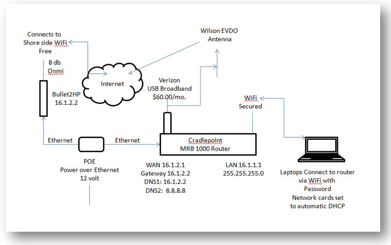

I just finished my document on how to set up the Bullet2HP along with the Verizon Broadband Card all connected to the Cradlepoint MRB100 EVDO router. See document here...
ipyoa.com/docs/cat_view/117-yacht-system...-a-computer-networks
download the doc here...
ipyoa.com/docs/doc_download/113-bullet2h...d-cradlepoint-router
Network Diagram
Last edit: 14 years 7 months ago by hayden.

Here is the hardware I used to make this work...
The Hardware and approximate costs
USB 720 Verizon Broadband Card ($60.00/month)
o www.verizonwireless.com/b2c/explore/?page=4g-usb-modems
Ubiquti Bullet 2 HP ($79.00)
o ubnt.com/bullet
Cradlepoint MRB100 EVDO Router ($200)
o cradlepoint.com/products/mbr1000-mobile-...3g4g-wireless-router
8db Omni antenna for Bullet2HP ($20.00)
o www.highgainantennas.com/ANT_OG081N_p/ant-og081nf.htm
Wilson EVDO antenna for Verizon broadband card ($25)
o 3gstore.com/product/2294_wilson-301133-r...t-mount-antenna.html
12 volt POE to power the Bullet2HP ($10)
o www.highgainantennas.com/product_p/hga-poe.htm
