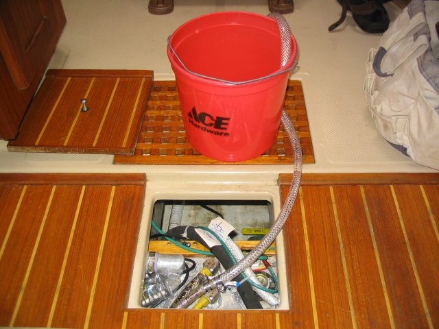

That is good you are taking out the chlorine, the problem with the water odor is not in the tank, it is in the plastic lines. So you need to run clorox solution into the lines once a year, let it set for 30 min and then flush it out. This is where the odor comes from. We never put anything into the water tank. We treat the lines once a year.
See the photo essay here:
ipphotos.com/view_ad.asp?Ad_ID=219

YES! NO Clorox in tank. Connect the hose/bucket to the tank pick up line that you remove from on top of the water tank. Extend this hose with a simple barb and longer hose to get into the bucket. Add clorox and water to the bucket, turn on the pump and draw in the mix running it out all your lines until you smell it. Then let it sit. Now to get really fancy, bypass the hot water heater...

2. What were the approximate proportions of out-of-the-bottle Clorox to water you used? (That is, how much Clorox did you put into the 5-gallon bucket in your picture?

We use 1/2 cup of clorox per gallon of water, so you can put 2 1/2 cups into the five gallons of water. I really don't think it is that critical as you are simply trying to get the Clorox into the lines.
