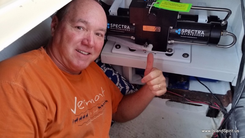

The install was very easy, I rate it a 3 out of 10 on difficulty to install. We decided to NOT have the Spectra MCP autop flush auto run $1,500 additional option because we will be aboard 100% of the time the unit is running and we can easily turn on the toggle switch to the pump and then dial up the clark pump pressure dial. That is all you have to do to run the unit. It is crazy EASY to run. The Spectra Ventura 200t is not cheap, it cost us $6,100.00 and we did the install ourselves while on a mooring ball in Stuart Florida, it took 3-4 days, that was it.
Knowing what I know now, I would do exactly the same thing again. This install took zero space, we lost nothing. It is all up high out of the way in the sail locker. The product water is plumbed into the hand pump hose and that works great. IT also was easy, and no back pressure issues.
So, if you are going off cruising for the Exumas or Caribbean and you plan to be onboard for a length of time, then the Spectra Ventura is a great unit. Note they make a 150 and a 200t. The 150 is for waters colder than 50 degrees F and the 200t is for waters 50 degree f and warmer. Well, I am never planning on being in waters colder than 50, so it was the Ventura 200t for us, plus it makes more water because it can run at a higher pressure.

Here is another report on our Spectra Ventura 200t watermaker. WE LOVE IT. It works great! It is very simple to run! I would install this same unit again the same way.
We are now in the BVIs and we are running the watermaker on longer runs, keeping it on for 2-4 hours every 4-5 days. We DO back flush the unit with our fresh water as recommended by Spectra. Above in this post I said I would not back flush the unit because I was planning on running it every day for 1-2 hours. Well, we have leaned that the unit prefers to be run longer than one hour, so 2-4 hours is best for use now. Then at the end of the run, we close the sea water intake and divert the pump to our water tank and flush out the sea water. When this is going on you can see the pressure in the unit will drop slowly to 30-40 PSI and then is when you can tell the unit has no more salt water. This takes about 1-2 minutes.
This unit makes 8 gallons per hour and it draws 8 amps of 12 volt DC power. We run it when we are motoring or when the wind is blowing 15+ or when the noon sun is strong. We have and we do run this unit of wind and solar many times.

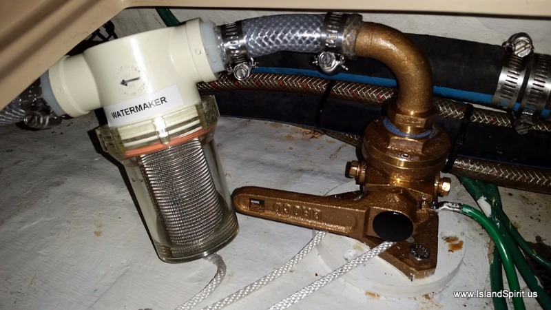

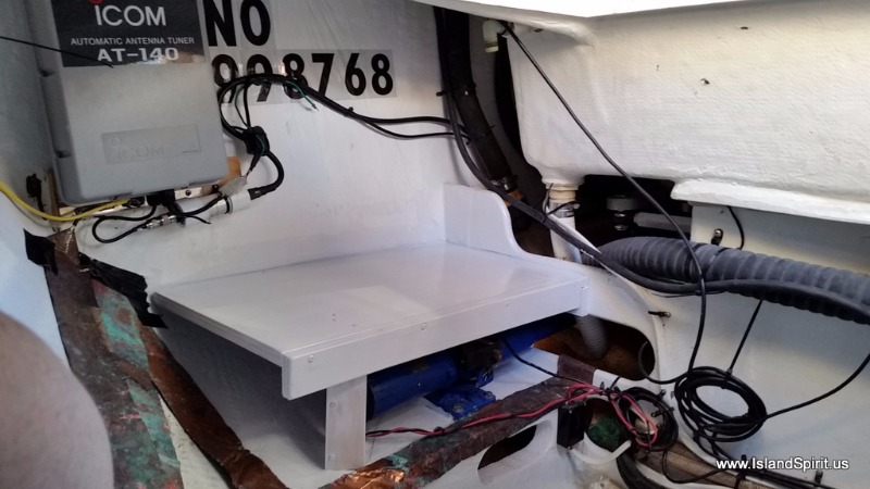

AS for our install. I would install this the same way again as we lost zero space, NONE! The pump and the filters are up high in the sail locker bolted against the cockpit seat ice box that no one uses for ice. The clark pump in mounted on a shelf over the our B&G autopilot where we stored nothing. The new sea water intake is in the galley floor next to the engine intake and the discharge is the T-ed into the ice box cockpit drain that no one uses. It worked out great.
