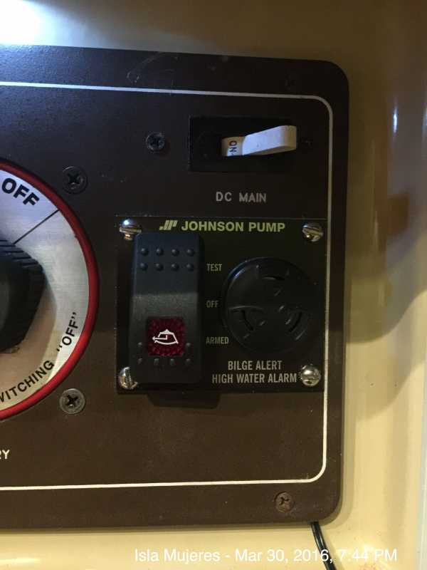

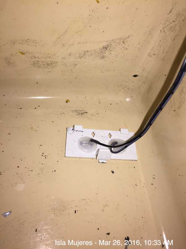

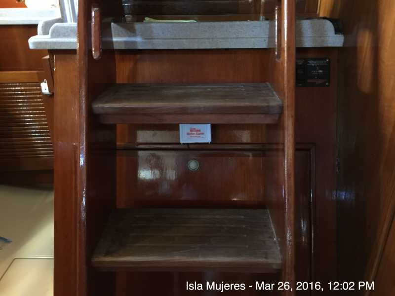

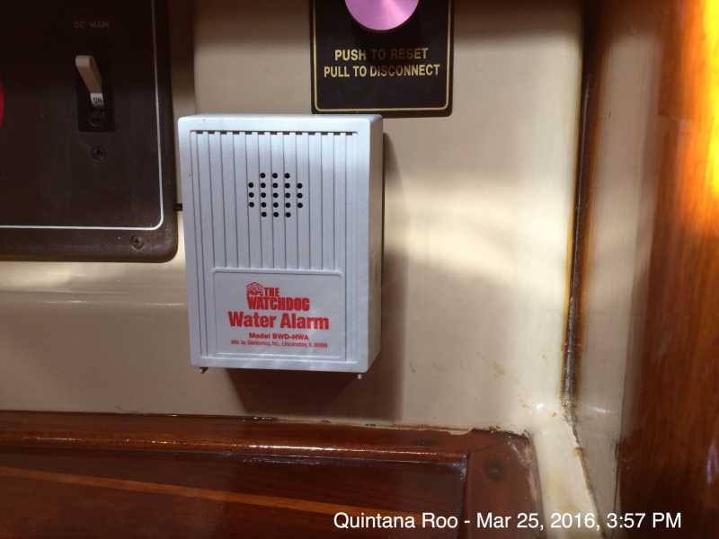

The attached pictures depict the easiest possible high water alarm solution. Andromeda has one of these 9v alarms for the bilge and one for the engine room as well as a hard wired 12v alarm for the bilge.
