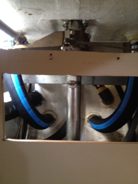

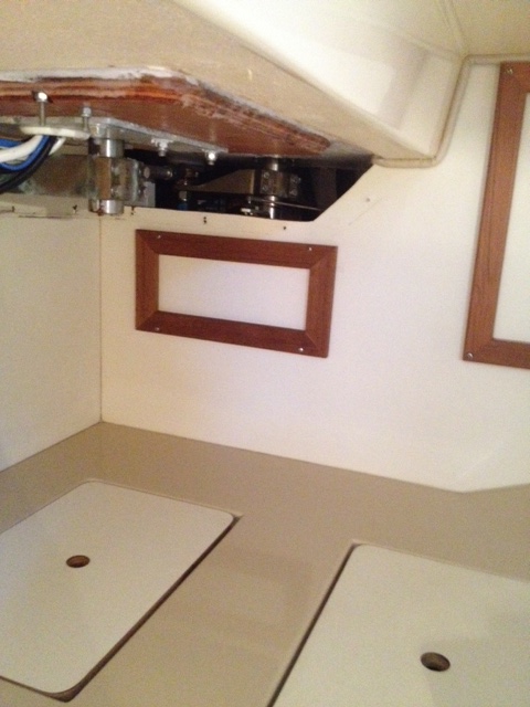

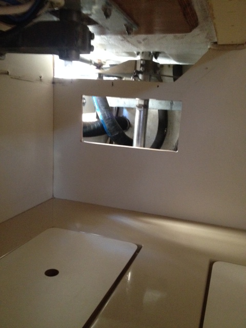

Thanks for the advice. I took it and am happy that I did. The following pictures show that results.
12 years 4 months ago #2762 by hayden
Replied by hayden on topic Re: IP40 Port Cockpit Drain Hose
THAT IS PERFECT! EXACTLY what is needed on these older Island Packet Yachts to easily access the stern and to gain access to the stern cockpit drain hoses.
OUTSTANDING JOB.
Thank you doe sharing these photos. This will help others.
