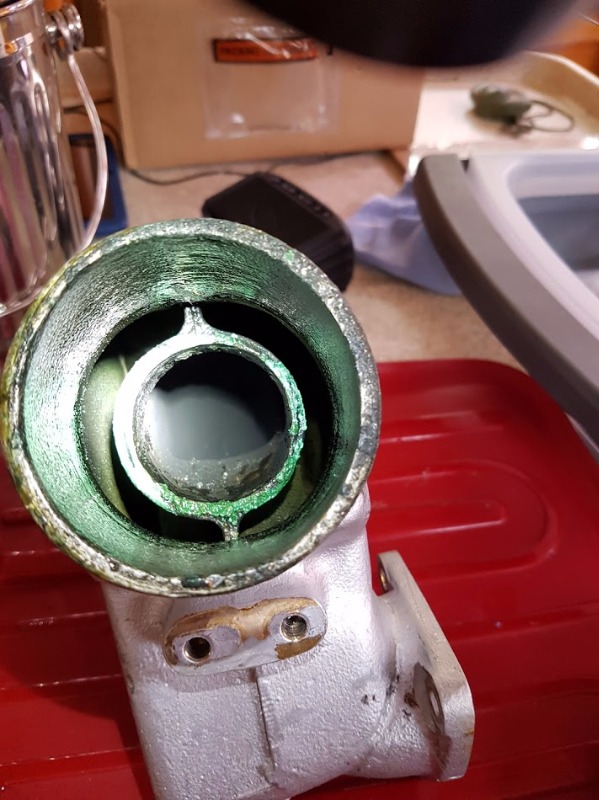

9 years 5 months ago #5487 by islanddreamer
Replied by islanddreamer on topic Yanmar Exhaust Mixing Elbows
I'm happy to announce that we pulled out exhaust elbow last weekend and it wasn't at all corroded. Just a small amount of soot. This was at about 750 engine hours so we won't pull again for another 1000.
9 years 5 months ago #5488 by hayden
Replied by hayden on topic Yanmar Exhaust Mixing Elbows
Blair:
The reason your mixing elbow was clean is because THIS is the square model, the newer design, the $900+ one, the one that does not clog. This is the GOOD ONE. It did not hurt to take a look at it, I just do not want others thinking they need to do this as well if they have the SQUARE model. This SQUARE design mixes the sea water into the exhaust in such a way that it does not build up like the U SHAPED one does. So you really do not need to do this at 1,000 hours. No need.
Good one = square = $900+ usually never needs service or cleaned, it does not build up
Bad one = U shape = $200 needs serviced, changed out because it DOES build up

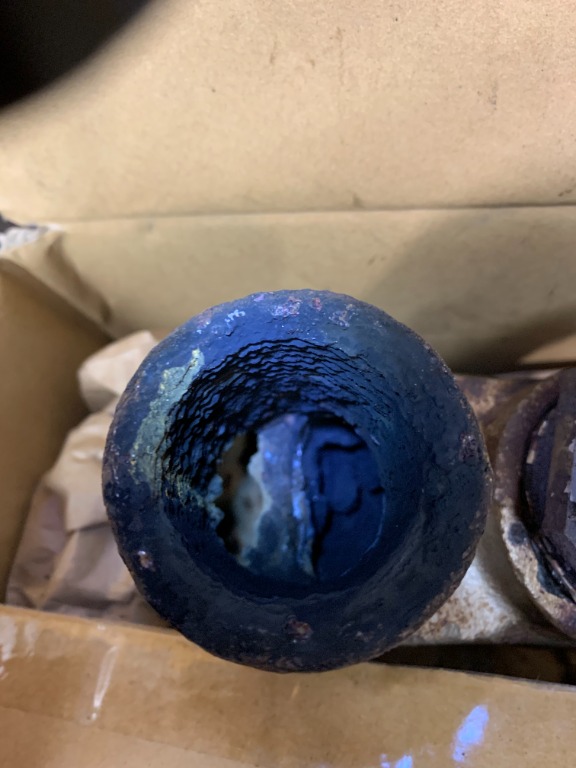

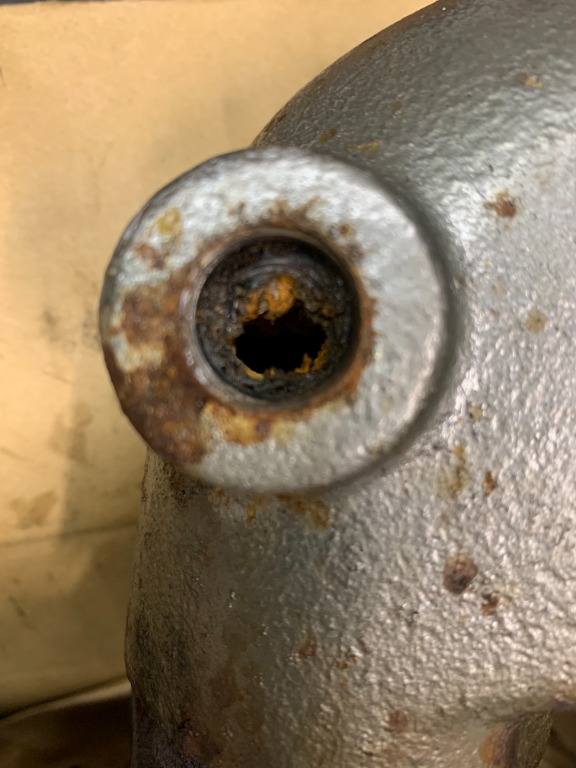

3 years 10 months ago #7333 by Vandergraaff
Replied by Vandergraaff on topic Re: Yanmar Exhaust Mixing Elbows
I just replaced this elbow yesterday on my 1985 2 cylinder Yanmar.  I put around 400 hours on this elbow but have no idea how many hours it saw before me.  As the photos show, it was badly clogged with carbon and some salts, and this was in the areas that are easy to see.  Normally the concealed areas are the worst so I have to imagine that my engine was not happy.
The replacement actually went very smoothly.  The 4 bolts holding the unit to the manifold came out with very little effort.  I am going to see if I can heat the old elbow with a torch and get it to release the old coupling for reuse.
Best,
Art
