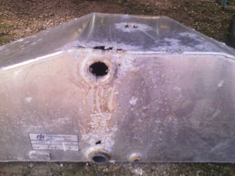

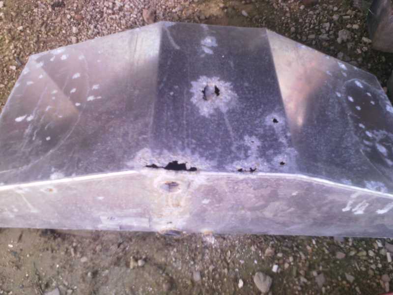

We're another metric to add to the leaking IP 380 aluminum holding tank. Forward seam failed this past week, with the "stuff" leaking into the bilge while we were underway on the Chesapeake Bay.
Karsten at IPY responded within hours of our note of the holding tank failure with detailed IPY drawings of the tank and surrounding timbers. He confirmed other comments here at the IPYOA that IPY will do the replacement for around $10K. It's a long run from the Chesapeake Bay to southern Florida. With the fall our prime cruising season, we have about a month to get the holding tank fix completed. Am working with Karsten on their glue and the holding tank support structure details so we can get the repair underway here in Virginia.

'Antares' (IP-380-89) is currently on-the-hard at Peakes Boat Yard in Trinidad getting the holding tank replaced by Craftline Woodworking. Craftline did this same job to another IP-380 who we contacted and were quite happy with the work Craftline did. The job on 'Antares' is in progress right now. We will not see the completed project until February. Attached are some pictures Narace Mahadeo sent me and the text of our quotation.
"To cut flooring in forward cabin and remove existing holding tank and make new fiberglass holding tank and to replace flooring and to strip-sand cabin sole throughout vessel and apply 8 coats of epiphane varnish" - $5800 USD.

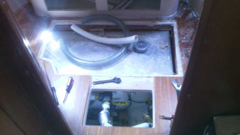

Ian...we are in the throes of replacing the 40-gal holding tank and sanitary hoses on our IP 380-88, The Belle of Virginia. We contacted several potential holding tank providers.
Stacy Evans at Wellington Plastics (This email address is being protected from spambots. You need JavaScript enabled to view it. 604.795.5106 in BC Canada) has the mold and has made several 3/8 poly holding tanks for the IP 380 and other IPs. Cost is $700 and $100 for shipping, about a week to build and ship.
We also poke with Gareth at DuraWeld (This email address is being protected from spambots. You need JavaScript enabled to view it., 561-586-0180 in Lake Worth, FL). Their price is $695, and 4-6 week build to ship time. They've provided many IP poly holding tanks.
Both the Dura-weld and the Wellington plastics tanks are 3/8" poly with a 3/8" protrusion on the tank face to hold the FNPT fitted access points, in the exact position detailed in the IP holding tank drawings. The tanks have baffles too.
Lastly, we spoke with Rich at Ronco PLastics (This email address is being protected from spambots. You need JavaScript enabled to view it.). They have not made many IP holding tanks.
We start the sole surgery this weekend, opening the sole to remove the holding tank. Karen and I are doing all the work ourselves. Have done enough fiberglassing, hardwood floor replacement, and cabinetry work that we're well underway.
ON the hoses. Many of the new sanitary hoses are a bit (up to 1/8") wider in outside diameter than the original hoses, so it may not be a simple pull out the old and replace with a new hose...Time to use the dremel tool grinding head.

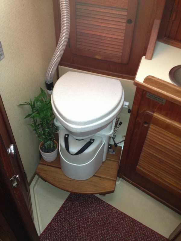

There is a solution for under $900. Anyone familiar with the Island packet 31 knows that it's waste holding capacity is completely inadequate for more than a weekend. Since we live aboard full-time I installed a nature's head composting toilet three years ago. Having live with it this long I have worked out the small kinks and have come up with a waste handling system that is easy, comfortable, and very efficient with no odor. And no maintenance issues. Dealing with a composting head is very akin to dealing with a home aquarium. You occasionally remove a little bit of compost, add a little fresh peat moss, stir often, maintain the proper moisture level and that's all there is to it. I usually go to months without having to mess with the compost at all. Then it's simply a matter of removing about a quart of the old compost and adding some fresh peat moss. The urine goes into a separate tank built into the head. And it gets poured out daily. If anyone decides to go that route then feel free to contact me for all the little tips and tricks to make the composter work at Peak efficiency
