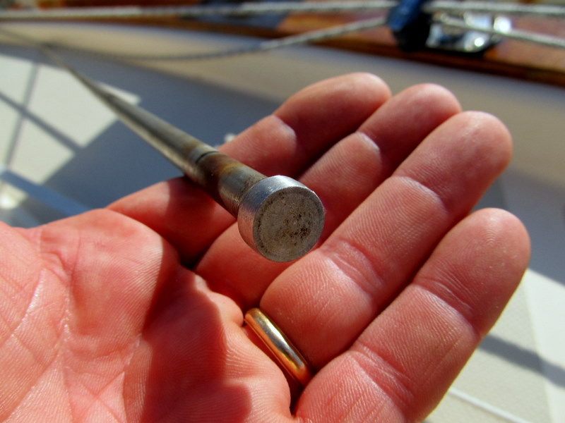

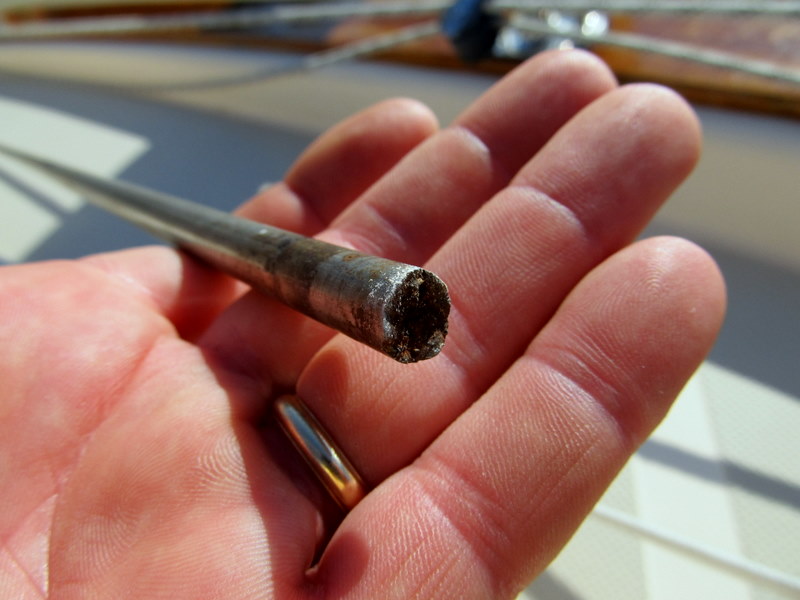

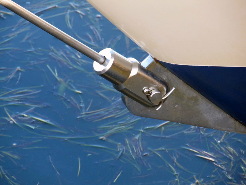

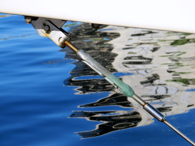

A fellow IP35 owner stopped by for a visit and brought with them this broken bobstay rod rigging off their IP35. It had broken and was only found by accident as they were working on the boat. This is the rod that goes from the bow sprite down to the waterline tank fitting. It opposes the forestay so it is a key piece of the mast rigging. They were able to have another rod made and they said is was easy to reinstall. I guess we all should take this part apart and look at it closely during our yearly inspections. This is something that cannot be inspected while it is rigged. The rod needs to be loosened with the turn buckle and then inspected. I would think it would be a good idea to also loosen the backstays to relax the pull on the forestay before removing this bobstay.

Broken end of bobstay
Non broken end
Bottom fitting
Top fitting

Lastly that broken end with the ragged edge as shown in the top photo,
looks like it was induced by mechanical damage or stress corrosion (impact damage) rather then just straight surface corrosion.
