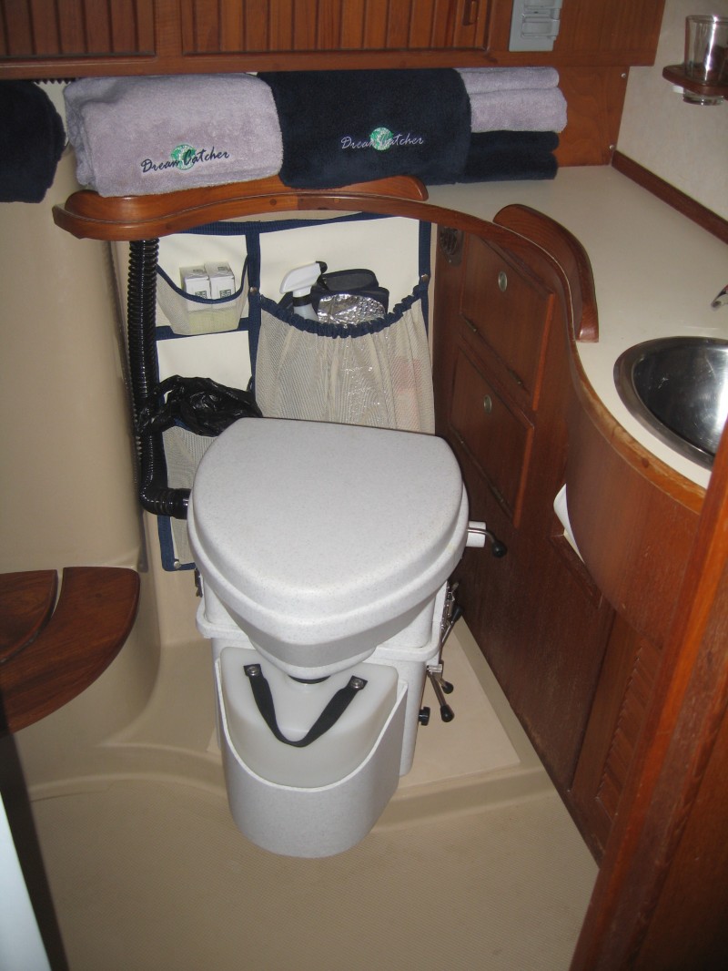

DreamCatcher's Head/Holding tank repair
by Bruce A Senay . Updated: 2 years ago . Taken at Jacksonville, FL
Jacksonville, FL View larger map
Natureshead composting toilet
head vent hose running from head  to solar vent
head solar vent
access to holding tank thru master bedroom floor before opening plywood bulkhead
new storage area below and aft of master closet
baffleoff
closet with new hoses, enlarged and new access holes
closet starting removal
closet start lower area
closet start before removing veneer covered plywood with 2 hidden screws into sub-floor
freeing back of closet floor
closet sub-floor with 2 screws visible that were hidden by veneer
closet sub-floor with enlarged and new access to allow removal of old hoses
deck clamp access on closet top after removal of teak with new hoses
deck clamps access with old hoses
drilled holes in back wall of holding tank prior to connecting with oscillating saw to break holding tank remaining into 2 parts
drilled back wall with top, floor and baffle of holding tank already cut out
floor of holding tank cut off
holding tank with large corrosion hole next to outlet fixture looking thru plywood bulkhead
holding tank close up
holding tank  beginning destruction
Bruce having fun and waiting for Happy Hour
holding tank inside
holding tank inside again including significant pitting corrosion on walls and roof
Area under holding tank. Another useful storage area now that I'm sure that it's impossible for things to disappear aft unless very small.
Lateral wing of tank being attacked. Access frequently only allowed 2 parallel cuts to be made then vise grips used to flex back and forth until snapped piece off.
Luke fluke ready for storage
luke fluke nearly into aft storage
Tank out with residual hard foam that tank rested on and kept it from moving. Will be used to fix shelf to when get around to installing.
tank pieces on way to recycler for $
